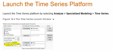

In addition, after you get a newer version, you want to check out the Box-Cox transformation feature added in a recent release.
See Launch Time Series
I am able to fit a plausible seasonal ARIMA (1,0,1)(1,1,0)19 model with lambda = 0.2174
