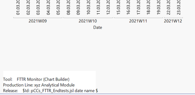

I have built an application with different charts, which are fed from different datasources. As the script, which is creating this dashboard, is updated from time to time, we want to keep track on its versions. I want to display the version on the dashboard as text. In the jsl script we feed the version by this command:
$ Id: xyz.jsl 18 2021-03-25 13:34:17Z name $
How can I display this text in a dashboard? It should not be static. A hardcoded text is not the way I am looking for.

no, it's the other way round. I am calling info from another source with JMP-JSL and want to have the info included as text in the dashboard. It should look like this:
In the dashboard script it may look like this:

				Text1 << Set Text(
Tool: 			FTTR Monitor (Chart Builder)
Production Line:	xyz Analytical Module
Release:  		$Id: pCCs_FTTR_Endtests.jsl date name $"
				), Text1 << Bullet point( 0 ), Text1 << Justify Text( "Left" ),
				Text1 << Rotate Text( "Horizontal" ), Text1 << Set Width( -1 ),
				Text1 << Set Wrap( 500 ), Text1 << Set Tip( "" ),
But I am not sure, if the readout would work having the part between the $-signs as plain text between "". What should be the syntax for integrating data as text in the textbox of a dashboard?

in the meantime I could test it. It works fine. Everything between the 2 $-signs are parsed by the version control software and in the next dashboard it appears updated. Thanks for help!
