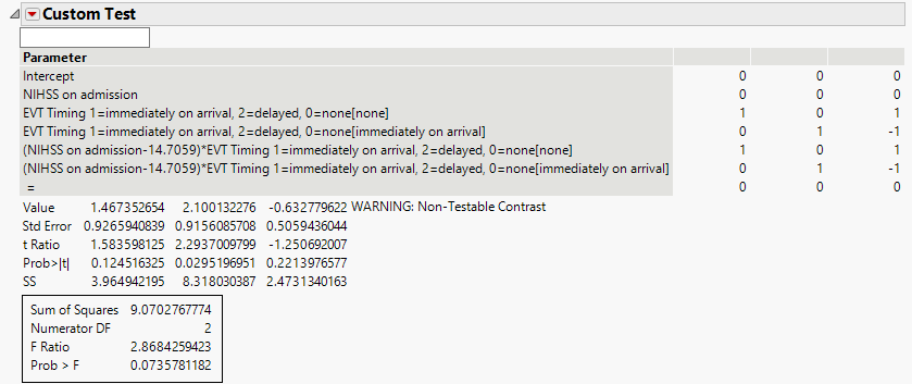

Hi @MRB3855, I took a shot at setting up custom tests for this purpose but can't seem to get it right.

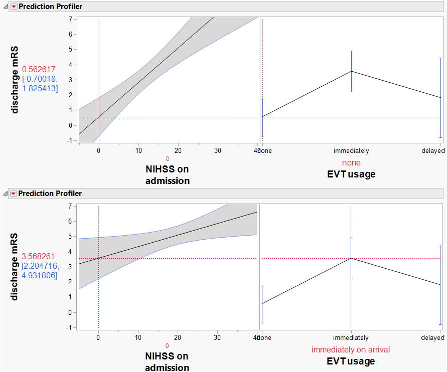

For example, in the picture below I'm attempting to compare EVT Timing = 0 (in column 1) vs. EVT Timing = 1 (in column 2), with NIHSS on admission = 0.
The numbers listed in the "Value" row in the first two columns of the test output (1.467 and 2.100) aren't equal to the values that my model predicts in those two conditions (0.0563 and 3.568, respectively - see prediction profiler below).

Similarly, when I attempt to repeat this custom test with NIHSS on admission = 20 instead (below), the first two columns of Value outputted (2.329 and 2.962) again do not match my model's predictions (5.105 and 5.089, respectively).
What am I missing here? Obviously it's something crucial, since the test "results" - which, if I'm understanding correctly, are supposed to be listed in the 3rd outputted column (difference in Value predictions, Std Error, t Ratio, p-value, and SS) - seem to be the exact same regardless of what I set NIHSS on admission to (which definitely shouldn't be the case).

Re: Test whether two predictions (via a multiple regression model) are significantly different
Hi @broccoli   You forgot the intercept (put 1 there in the first two columns).
And are you sure it doesn’t matter what NIHSS on admission is?
Edit: Hmmm, I'm not so sure it's working as i expected when there are interaction terms involving the covariate.
Stay tuned.
