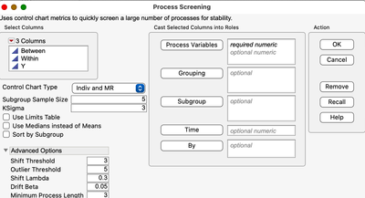

statman
Re: Test carte de contrôle
There are many options in Process Screening (see advanced options)
https://www.jmp.com/support/help/en/17.0/?os=mac&source=application#page/jmp/launch-the-process-scre...
The documentation states that Process Screening follows the same test customizations that are made in the control chart builder preferences.
The Process Screening Report (jmp.com)
"Tip: The eight Nelson tests in the Process Screening platform follow the test settings in the Control Chart Builder platform preferences. You can customize the tests at File > Preferences > Platforms > Control Chart Builder."
So yes, you can customize the control chart test rules in Process Screening.
