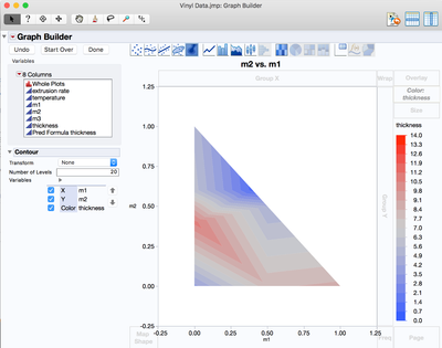

Have you tried Graph Builder?

Hi Lou,
Unfortunately it's the Ternary Plot I need to use; however I've just reproduced your chart above, and the Graph Builder does provide a clue - but not  the answer.  If I load the Donev Mixture data from the Design of Experiments section of the Sample Data, then remove all the terms involving :Wavelength from the model , fit it, and then save the prediction formula for :Damping back to the data table, I can compare the Graph Builder and the Ternary Plot functions directly by

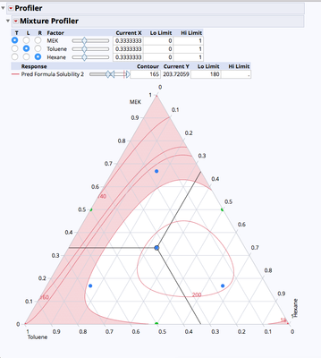

The Mixture Profiler is worth a look as well. The number of contour lines is editable.
