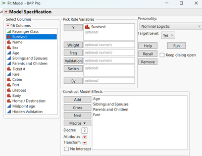

I am running Model screening to predict a target outcome ("Yes"). My problem is that In Fit Model the Target level is always set to the wrong level (the majority class "No"). I already have changed the value order in the column info of the target column, however without result. Moreover, if I run the Model screening platform I can not choose the target level myself. How can I change the level of my target to my preferred level (e.g. "Yes" instead of "No").?

Hi @Lu,
Is your response a binary response (only yes/no possible responses) ?
If yes, the Fit Model platform should display the target level and you can modify it:
In Model Screening, the target level is not displayed indeed.
Can you provide a anonymized dataset to reproduce the problem ?

You can set the Target Level as a Column Property, and wherever it's appropriate, JMP should automatically take this into account. The screenshot below is from the Diabetes sample data.

Thanks Jed for the response. I was not aware of this function in the column properties. And it works as well in the model screening platform !
