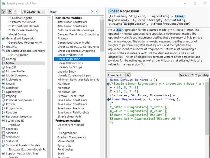

Using the JSL function called Linear Regression(), it should be easy to move the X and Y data that is right of the critical point, and to retrieve the intercept.  Look into the Scripting Index for Linear Regression.

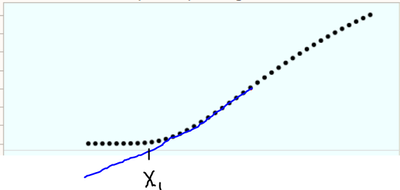

The curve will be similar to the picture below, the point where the blue line originates is the critical point for the tangent line to be extrapolated to horizontal axis.
Let me know if this makes sense
Thanks
Re: Tangent Line extrapolation from a known point on cuve
It looks like you are hunting for the linear portion of the curve and then estimating the x-intercept.
