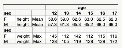

Not sure if this is what you are after:
If so, you can do this via 'drag and drop' by having two row tables.

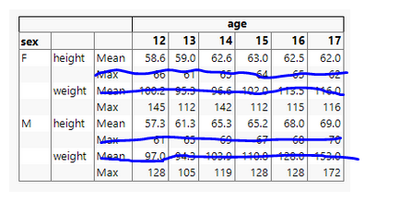

Actually the "exact" template I had in mind was something like that:
But maybe I have to put it on the JMP Wish List (since Christmas is coming :)
