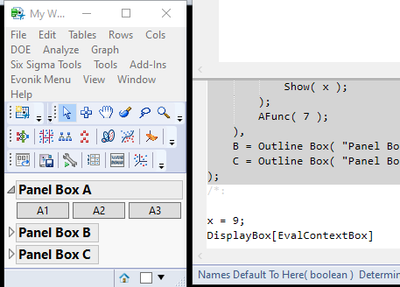

  I tried several different approaches, and although you can define a function within an outline box, see the example below. You apparently can't refer to another outline box within the function call (JMP complains about a deleted reference to the other outline boxes), and Outline Box() doesn't accept the send command <<Set Function(Function({this}, script)).

The above script gives the following output:
It clearly generates the desired window and displays the output of the function, which is x=9. But, I was unsuccessful in trying to create a function within the Outline Box that accessed the state of another Outline Box and dynamically closed/opened accordingly.
