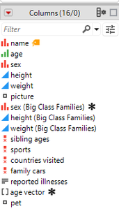

Available columns after executing the script 1x, 2x  and 3x in JMP18 *):

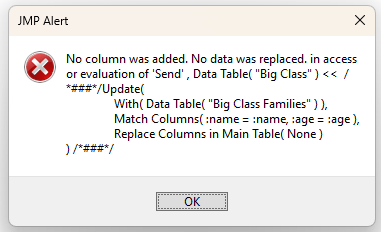

*) after adding new columns in the first step, no new columns are added. JMP informs the user:

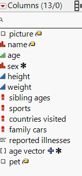

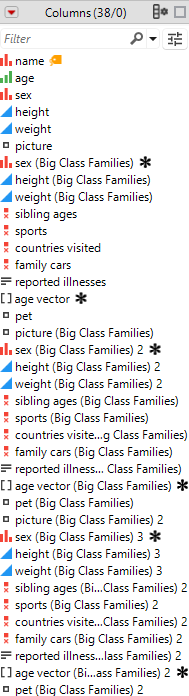

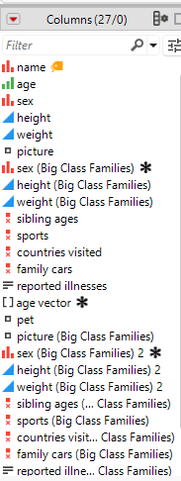

Available columns after executing the script 1x, 2x  and 3x with JMP19:

This wish is great, as an option - but it might collide with how other users used Tables/Update up to now.
Especially dangerous if scripts are affected.
Can the new functionality be disabled?
