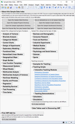

JMP also offers teaching scripts in Sample Data which might be helpful for some demonstrations:
