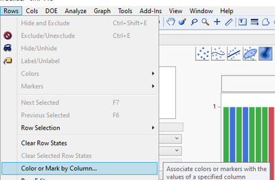

There is also option to use Color or Mark by Column... but you would run into same issue if you want to use different color for same state in different plots.
