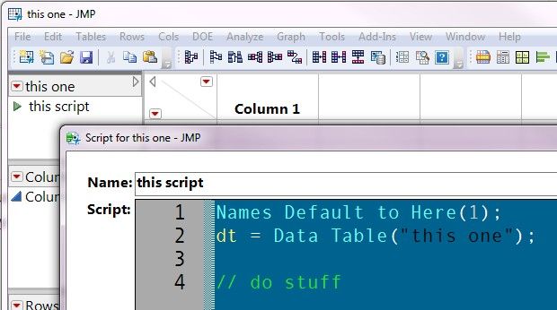

I have a set of scripts that I copy to new data tables. To make sure that when I run the table script it acts on the data table it belongs to I have to edit all of the scripts to point to the right data table (dt = Data Table("this one")). Is there a generic way to reference the parent data table, similar to dt = Current Data Table(), but more like dt = Parent Data Table()?

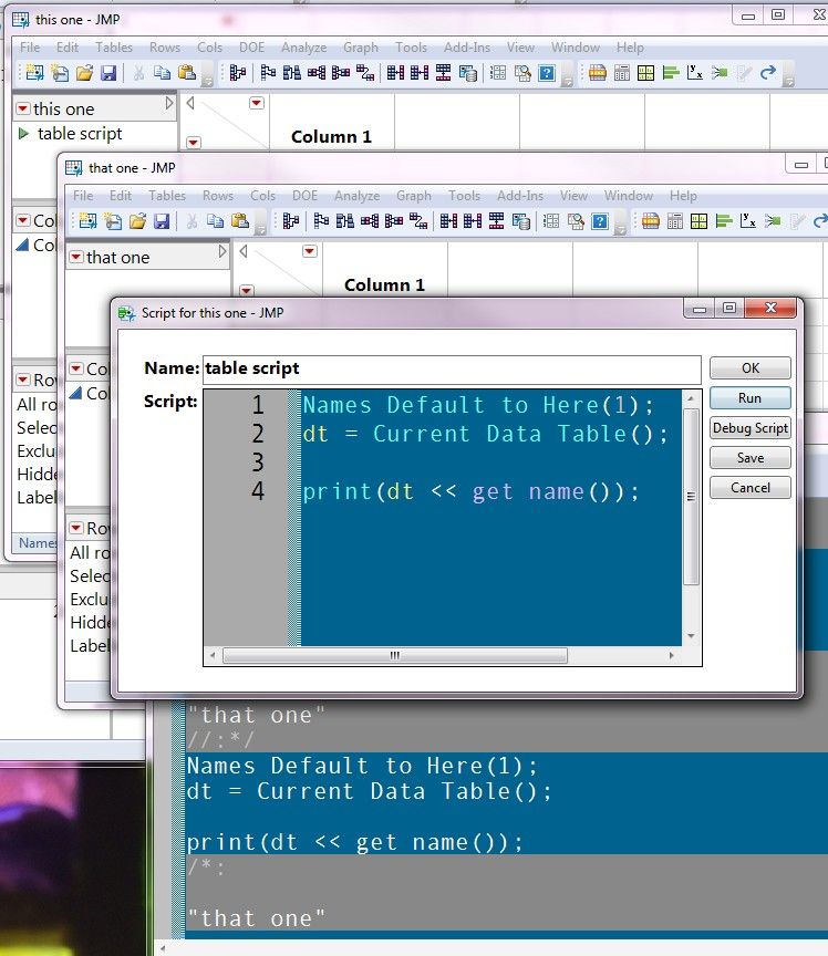

If the script is open for editing, running the script from the editor will grab whichever data table is current using dt = Current Data Table(). The only way to guarantee that the script will point at the right table is by being explicit about the table the script should act on (which is what JMP teaches in the Intro to Scripting class as a best practice), so I'm looking for a way to do that generically so I don't have to constantly update the scripts everytime the data table name changes.
In the attached photo, the table script belongs to Data Table("this one") and Data Table("that one") is the Current Data Table(). If "when you run the table script, the table that it is associated with is the current data table" then the result of the scipt should be "this one" not "that one"
