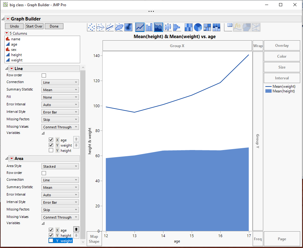

You can do this by going to the configuration area in Graph Builder, for each of the types of displays you want and to change the "Variables" selection to indicate which of the variables you want to have for the specific type of display.  Below is a graph that has both Height and Weight specified for the Y Axis.  Both an Area and a Line display has been specified.  For the Line graph, only the X axis variable, Age and the Y axis variable, Weight are selected.  For the Area chart, only the Age and Height variables are selected.

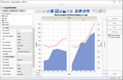

Hi @hillel ,
  One possible option is to move one of the Y variables to the right side of the graph and then select the line graph style in Graph Builder (the left Y variable will be the line). I was able to get this to work with the Big Class data set, graphing weight vs age and height vs age -- weight as the fill to bottom area under curve and then height as a red line, I even wrapped it by "sex", so it's something like your data. I changed the axes so that it kind of separated the weight/height data, so it's easier to see.
  I've attached a screen shot of what Graph builder looks like.
  This is one possible solution, but I'm sure there are others, and someone else is sure to have a better solution.
Hope this helps!,

txnelson
Re: TWO Y VAR with different visulisation in graph builder
Hi @hillel ,
Hope this helps!,
