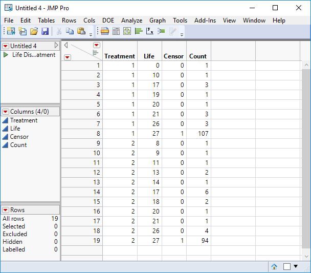

You do not define what you mean by "survival analysis."JMP expects the data in a particular layout for some analyses.
Your data includes 6 blocks of 27 days for each treatment. What is the blocking about?
Your data appear as though they came from a spreadsheet and you were setting it up for a manual calculation. That step is not necessary for JMP. JMP expects the following information for survival for each observation (subject):
  • The life time. This time can be exact (dead) or censored (alive).
  • An indicator of exact or censored life.
That information is all that is minimally required. You also have treatment and multiple deaths on some days. This layout can include a count of observations at a given time, which can be used in the Freq role.
I assume that the 120 subjects for Treatment = 1 and the 114 subjects for Treatment = 2 are the same throughout the 27 days. That is, you are not treating 120 new subjects each day. So a probit analysis is probably not what you want. You can compare the life distribution of the two populations with Analyze > Reliability and Survival > Life Distribution.
Set your data up like this:
I am only showing 1 block of 27 days for each treatment. Notice that only the exact deaths are entered as observations and all the alive subjects are counted at the end of the study. (Type I censoring).

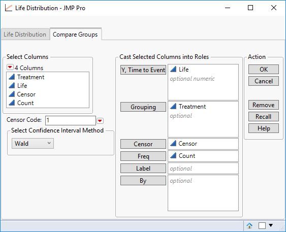

Then set up the analysis like this:

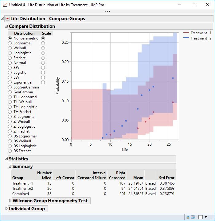

The results appear like this:

You can compare groups in Life Distribution. There is a special tab in the launch dialog for such an analysis.
