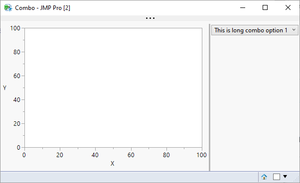

Re: How to modify font size of text inside combo box?
If you are working with a window that is stretchable, you might consider making the Combo Box stretchable as well.  It will take min and max sizes, and while it prefers the full size of the text, it will shrink to a smaller size if forced to by a box like Splitter Box.  It does not offer truncation options, so you will only see the first part of the string.
New Window( "Combo",
	H Splitter Box(
		Size( 600, 300 ),
		gb=Graph Box(),
		combo = Combo Box(
			{"This is long combo option 1 that I would like to truncate",
			"This is long combo option 2 that I would like to truncate"},
			<<Set Min Size( 30, 1 ),
			<<Set Max Size( 3000, 1 ),
			<<Set Auto Stretching( 1, 0 )
		<<Sizes({0.7,0.3})
gb[FrameBox(1)] << Set Min Size(30,30) << Set Max Size(3000,1) << Set Auto Stretching(1,1);
