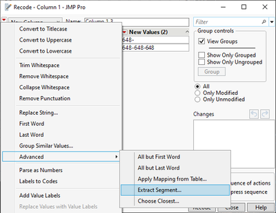

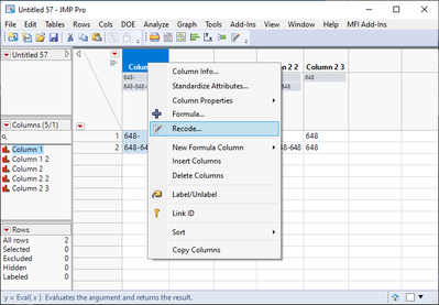

If your data is always like that, you can use Word()
Word(1, :Column 1, "-")
:Column 1 is your column with your values.
You can also use Recode:
