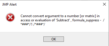

I was trying to use the script below to suppress eval or allow eval for all column formula in the table. For some reason, I kept getting an error (see snapshot) on the third time running the script but I can't particularly find the bug. Appreciate the community help in debugging this.

The syntax error that was causing the failure was because the
formula_suppress = dt:Formula_Suppress,
was not returning what you were expecting.  Below is a rework of the code that returns properly when the Table Variable does not exist
