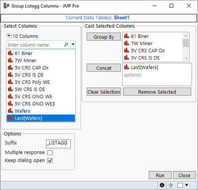

There is also this addin written by me Group Listagg Columns which you might be able to utilize.
