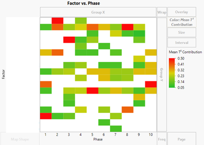

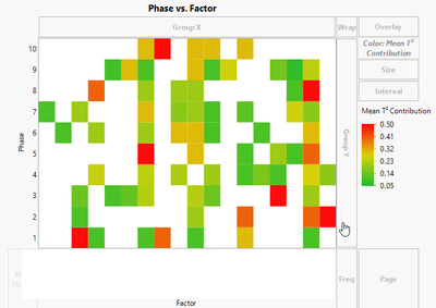

  Good suggestion, and thanks for the quick feedback. Just to give you an idea of what it looks like, there are two versions below, one with Phase vs Factor and the other with Factor vs Phase. Both are colored by the Mean T^2 Contribution. To me, the Factor vs Phase makes a little more sense because the Phase # corresponds with time. I can mess with the color scheme some more, but overall from the previous examples and these two, is there one that is more "readable"/"understandable" than another?
  I REALLY appreciate the feedback and thoughts on this, as I'm trying to convey the message in the simplest way possible.

I agree with your 2nd one and the reasoning that phase is associated with time and makes more sense on the x axis.  Regarding color, I'd suggest a monochrome color scheme (black-white works, but if you insist on color, try the blue gradation scheme) - in this case, diverging colors don't convey any useful information since the measure is just a measure of strength of effect.  Also, if the gradations don't show sufficient detail, you can try a quantile gradient.  It will show lots of variability, but perhaps invites misunderstanding about the actual strengths of the effects.

  Thanks for your thoughts and feedback, I appreciate it. I also came to a similar conclusion about the color, the monochrome color scheme is better and not as busy to look at, which really helps. I think the other thing that helps is to change the gradient to discrete as this helps to delineate the changes better.

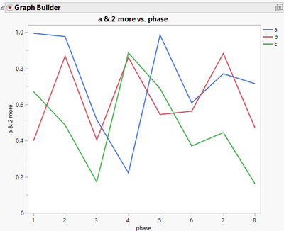

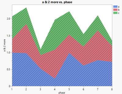

Would simple overlay lines and stacked lines be relevant?
In the following, different colors represent factors, and phase is on x-axis.

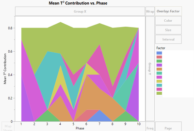

  Thanks for your suggestion, and I like it. Unfortunately for me, I have several factors that end up making a simple line or stacked line plot a bit "messy". As a result, it doesn't really show as well how a property might change. If it were only a few, say 3 or 4, I could see this working well. For my case, it ends up looking something like this:

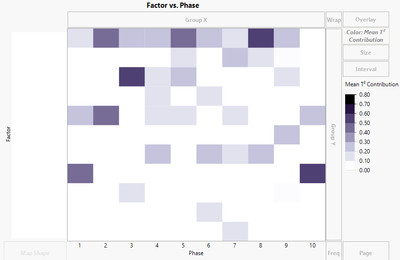

  Even changing it to a monochromatic scheme doesn't help much. At present, I'm partial to a monochromatic heat map style with discrete color levels. This style ends up looking like this, which I find to be simple and able to show how a factor (y-axis) changes with Phase/time (x-axis). It also helps to show which factors come and go from Phase to Phase.
  That being said, I'm always open to other ways to represent the data so I can make it as easily understood by my audience as possible. I've tried a bubble plot, which did not look good, but I thought that could be an interesting way to illustrate the changes, but it's not so good in this case.
