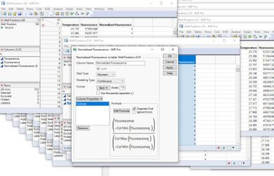

Adding the new column after the subset works for me, not sure why, and it is correctly titled, but the formula doesn't "calculate" which is why I thought it might be the "eval" thing I've seen. When I go into the new columns, it has "suppress eval" on but I don't know how to fix that without going in by hand to all of the subsets and correcting it.
I attached a screenshot of what it looks like to me. The column appears, but with the dots. When I go into column info, it has the "suppress eval" checked, and unchecking it solves the error, but it's not ideal to have to go into all of the subsets individually to uncheck the box. I tried adding different codes to the script to turn off suppress eval, but none of them work so far.

Thank you so much!! The first solution worked perfectly. I'm sure you hear this all the time, but you are a life saver!
