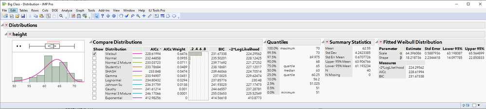

In the script below, I was expecting the returned title to be "Fitted Weibull Distribution" but I get "Fitted Normal Distribution" instead. I'm not sure what's wrong, really appreciate the help.
names default to here(1);
db = dt << Distribution(
	Stack( 1 ),
	Continuous Distribution(
		Column( :height ),
		Horizontal Layout( 1 ),
		Vertical( 0 )
db << fit all;
Title_1 = report(db)[Outlinebox("Fitted?")] << get title;
print(Title_1);

txnelson
Re: Subscript reference wrong display box
My guess is that JMP creates in memory all of the Fitted outputs so when you ask for
The Fitted Normal is the first one in Memory, and therefore it is the one returned.  You can bypass this issue with
Title_1 = report(db)[Outlinebox("Fitted Weibull?")] << get title;
Or
Title_1 = report(db)[Outlinebox( 6 )] << get title;
Jim
jthi
I think all the different fits are still there even if they aren't visible (they are under If Boxes), report subscripting will still match those and finally using ? wildcard search will match the first outline box which satisfies your search (in this case Fit Normal Distribution)
You can use JMP to build the path from Show Properties menu (box path)
Report(platform)["height","Fitted Weibull Distribution"]
You could write longer search term (I would avoid ? whenever possible)
Title_1 = report(db)[Outlinebox("Fitted W?")] << get title;
Or use XPath and get all the titles and get what you want from that
fit_obs = Report(db) << XPath("//OutlineBox[contains(text(), 'Fitted ')]");
fit_obs << get title;
-Jarmo

Djtjhin
Level IV
I think this is getting close to what I'm looking for. What I'm trying to do is get the user-selected distribution(s) and the respective parameters. I tried to modify the script to below but it doesn't necessarily give the right output. Could you help point out where I did wrong ?
Additional, this also raised few other doubts:
- why does the << get selected indices as matrix message returns the result in reverse order ?
Names Default To Here( 1 );
	Stack( 1 ),
		Column( :height ),
		Vertical( 0 )
db << fit all;
rpt = db << Report;
rpt["Compare Distributions"][CheckBoxBox( 1 )]<<set(3,1); //make additional random selection
wait(1);
dist = rpt["Compare Distributions"][String Col Box( "Distribution" )] << Get;
matrix = rpt["Compare Distributions"][CheckBoxBox( 1 )] << get selected indices as matrix();
matrix = reverse(matrix);
index = loc(matrix,1);
for(i=1,i<=nitems(index), i++,
	Title_1 = rpt[Outline Box( "Fitted" || dist[index[i]] || "?" )] << get title;
	Print( Title_1 );
Appreciate the help so far

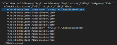

Djtjhin
Level IV
Thanks @jthi!  That works!
Btw, for my learning, I wouldn't have come to using 'ischecked = "true"' syntax as I didn't find this in scripting index nor in displaybox properties themselves. Could you share how you derive this? Would be nice for me to learn this process for future references.
jthi
I used << Get XML on the Table Box reference to see if there was anything interesting I could use to get what I wanted to
-Jarmo
