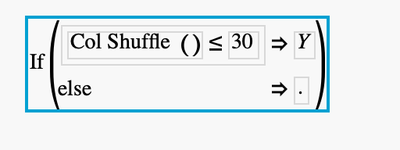

I quick way to do a subsample using a column formula is the use the Col Shuffle() function.  The function returns a random reordering of row numbers.  If you choose rows where the values of Col Shuffle() are less than than or equal to the subsample size (n_sub), this equivalent to doing a random ordering of the column and selecting the first n_sub rows.
For example, adding new column with this formula will do this for a subsample size of 30.
example table attached.

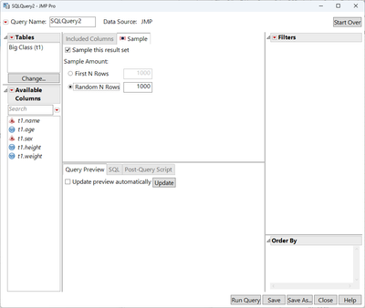

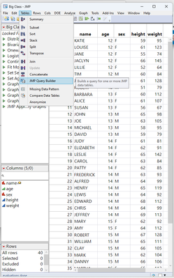

Hi @paulp ,
the other non-scripting solution that can be useful in such applications is using JMP query builder under the Tables menu.
there you can find a random sampling tab as in the picture
As usual one you run it interactively you can make use of the script created for additional usage.
