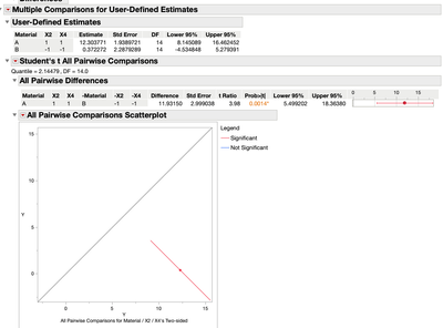

You could use Multiple Comparisons with user defined estimates.  Just define estimates at the optimum conditions for each material.
