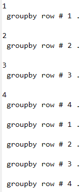

hogi
Level XIII
Re: Statistical functions (Col Mean for example) possibly bugged on first row of data table when using << Set Each Value to replace values in column
@hogi wrote:
After adding some additional formatting to the value printout, Col ... aggregation switches to the very slow mode which is already known from here:
How-do-I-use-the-Col-Maximum-Formula-with-a-quot-where-quot/m-p/578576/highlight/true#M78599
I just checked the behavior with Jmp 17.2 and later versions (<=18.1.1). The issue is gone:
dt << Clear Select << Select Rows( Index( 5, 40 ) ) <<Delete Rows;
newCol=New Column("new");
newCol << Set Each Value(Col Mean(Print(row());:height, write("\!n groupby row # ",row()," ",newCol[row()],"\!n");:age));
gives:
so, the value and GroupBy values are calculated for every row - then the GroupBy values are calculated again for every row.
That's it.
