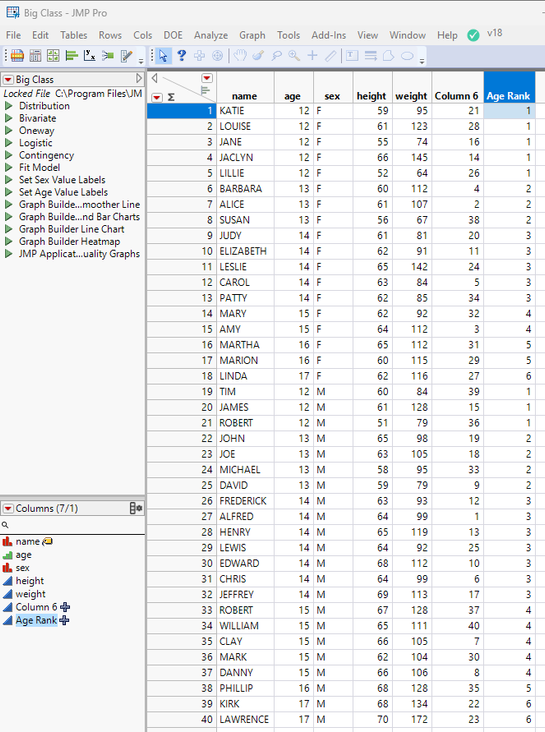

If I have a column of nominal data where the inputs can occur more than once, is there a way to have a column whereby the output is the alphabetical ranking of the input?  I can go the scripting route but I'd prefer a simple column formula.

It is late in the day, so my solution is probably not the best, however using the Big Class data table, Here is the formula I came up with
As Constant( Summarize( theLevels = by( :age ) ) );
Contains( theLevels, Char( :age ) );

Until we get Add dense ranking to Ranking Tie and Col Rank functions I would use something like txnelson did show in simple cases. There are all sorts of solutions using Col statistical functions but they tend to be very difficult to understand as you have to combine multiple of them and inside of each other (you can find some from the comments of that wish list item).

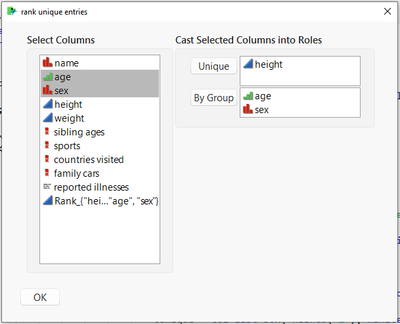

Names Default To Here( 1 );
Try(
	dt = Current Data Table(),
	Caption( "no dat table" );
	Stop();
updateLBox = Function( {t},
	(t << sib) << setitems( (t << topparent)[listboxbox( 1 )] << getselected )
nw = New Window( "rank unique entries",
	<<Type( "Modal Dialog" ),
	<<return result,
	Border Box( Left( 10 ), Right( 10 ), bottom( 5 ),
		V List Box(
			Lineup Box( N Col( 1 ), spacing( 10 ),
				// Text Box( "XG Boost Specification" ),
				// colistbox only necessary if the script is standalone
				H List Box(
					Panel Box( "Select Columns", Col List Box( all, nlines( 15 ) ) ),
					Panel Box( "Cast Selected Columns into Roles",
						Lineup Box( N Col( 2 ),
							Button Box( "Unique", <<setfunction( Function( {t}, updateLBox( t ) ) ) ),
							Cunique = Col List Box( nlines( 2 ), minitems( 1 ), maxitems( 1 ) ),
							Button Box( "By Group", <<setfunction( Function( {t}, updateLBox( t ) ) ) ),
							CBy = Col List Box( nlines( 2 ), minitems( 0 ) )
			Spacer Box( size( 1, 10 ) ),
			Button Box( "OK",
				<<setfunction(
					Function( {t},
						ColsUnique = Cunique << get items;
						ColsBy = Cby << get items;
If( Not( nw["Button"] == 1 ),
	Stop()
myCol = dt << New Column( "Rank_" || Char( ColsUnique ) || If( N Items( ColsBy ), "_by_ " || Char( ColsBy ), "" ) );
colName = mycol << get name();
groupExpr = Expr( Group() );
For Each( {col}, ColsUnique, Insert Into( groupExpr, Name Expr( As Column( col ) ) ) );
For Each( {col}, ColsBy, Insert Into( groupExpr, Name Expr( As Column( col ) ) ) );
mainCommand = Substitute( Name Expr( groupExpr ), Expr( Group() ), Expr( Concat Items() ) );
If( N Items( ColsUnique ) == 1,
	columnsExpr = Eval Expr( Columns( Expr( Name Expr( As Column( ColsUnique[1] ) ) ) ) ),
	Caption( "multiple columns not implemented yet" );
	Stop();
GroupByExpr = Expr( Group By() );
For Each( {col}, ColsBy, Insert Into( groupByExpr, Name Expr( As Column( col ) ) ) );
Eval(
	Eval Expr(
		myCol << set formula(
			As Constant(
				dt0 = Current Data Table();
				dtsum = dt0 << Summary( Expr( Name Expr( groupExpr ) ) );
				newCol = dtsum << New Formula Column(
					Operation( Category( "Distributional" ), "Rank" ),
					Expr(
						Name Expr( Columns Expr )
					Expr(
						Name Expr( GroupByExpr )
				newcol[1] << set name( Expr( colName ) );
				dtsum << run formulas();
				dt0 << Update(
					With( dtsum ),
					Match Columns( Expr( Parse( "dt0:" || ColsUnique[1] || " = dtsum:" || ColsUnique[1] ) ) ),
					Add Columns from Update Table( none ),
					Replace Columns in Main Table( Expr( colName ) )
				Close( dtsum, noSave );
				Stop();
			Expr(
				Name Expr( mainCommand ) // will never execute - ut needed for the automatic update : )
dt << run formulas();
Workflows\BuildingBlocks\ColumnOperations\RankUnique_with_ByGroup.jmpflow
SpannerHead
Level VI
Re: Alphabetical Ranking of Nominal Data
hogi
This one's really clever.  I can enter multiple values in the By Group if I hold down the Ctrl button but it only operates on the last entry for the number of inputs.  Am I doing something wrong?
Slán
