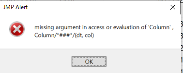

I tried the script but i got this alert instead. what shoud i do?
jthi
Re: Standardized Group column attributes
That script is also using For Each which was also added in JMP16. You would have to convert it into For loop which would look something like this
Local({old dt = Current Data Table()},
	Current Data Table(Data Table("Big Class"));
	collist = old dt << get column group("height etc.");
	For(i = 1, i <= N Items(collist), i++,
		col = collist[i];
		col << Data Type(Numeric) << Set Modeling Type("Nominal");
	Current Data Table(old dt);
Depending where the script is being run, it could also be cleaned (at least in my opinion) a bit to something like this
Names Default To Here(1);
dt = Current Data Table();
// dt = Open(); // use this if possible
collist = dt << get column group("height etc.");
	col = collist[i];
	col << Data Type(Numeric) << Set Modeling Type("Continuous");
-Jarmo

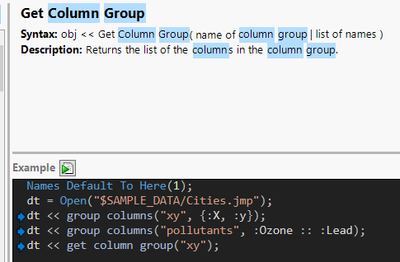

Next search scripting index for column group (or something similar)
after small modification (I change data type and modeling type back to numeric)
