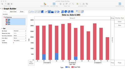

KarenC
Super User (Alumni)
Re: Stacking Bar Charts
This can be done in graph builder.  I did it by using 4 columns: Date, ABC, Data, and Type"
Date ABC Data Type
01/01/2015 A 3000 Case Rate
01/01/2015 B 2500 Case Rate
01/01/2015 C 3100 Case Rate
01/01/2015 D 2400 Case Rate
01/02/2015 A 3150 Case Rate
01/02/2015 B 3220 Case Rate
01/02/2015 C 2500 Case Rate
01/02/2015 D 3000 Case Rate
01/03/2015 A 2500 Case Rate
01/03/2015 B 3200 Case Rate
01/03/2015 C 2812 Case Rate
01/03/2015 D 1990 Case Rate
01/01/2015 B 500 Adj
01/01/2015 D 594 Adj
01/02/2015 C 300 Adj
Then nest ABC within Date on the x-axis, Data for the Y and Type for the overlay and then in the menus in the control panel select stacked. Then you can add additional spacing or lines between groups using the axis settings and other menu options.
