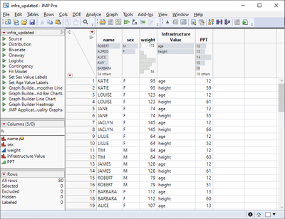

For me it works fine in JMP18 (and 17) when I test it with the example I left in the code
Names Default To Here(1);
cols = {"age", "height"};
infr = "Infrastructure Value";
data = "PPT";
output_name = "infra_updated";
dt_stacked = dt << Stack(
	Columns(Eval(cols)),
	Source Label Column(infr),
	Stacked Data Column(data),
	Output Table(output_name)
Are you sure the column names are written correctly and they are in a list?
