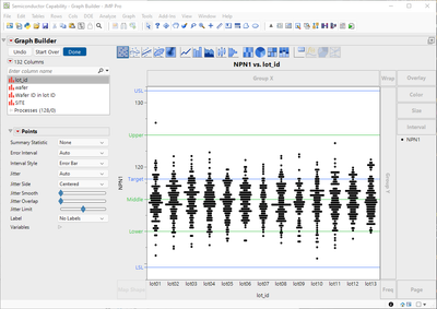

You can only set one pair of spec limits as column properties. You could use Response Limits as one extra pair of limits but it can possibly mess with some platforms
Just spec limits
With response limits
Usually for situations like this, I would go with stacked data table and then you can display as many limits as you wish to, as you can just add them as extra lines IF you are using Graph Builder. There is also much more script heavy option of using reference lines /graph scripts for the extra limits
