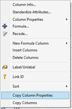

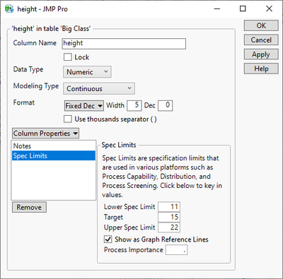

To see what type of syntax to use, set limits manually to some column
Right click on the column header after adding the limits and select Copy Column Properties
and paste the results somewhere
Add Column Properties(
	Set Property("Notes", "Explore data adventurously"),
	Set Property("Spec Limits", {LSL(11), USL(22), Target(15), Show Limits(1)})
-Jarmo
-Jarmo
