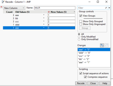

Hi,
I have a categorical column that has repeated same string order randomly. I want to label number to each group that has same string like the example in picture. How I can do to create the column of result?

how about using "recode new colum";
script:
// New data table
// → Data Table( "Untitled" )
New Table( "Untitled" );
// Recode column: result
Local( {dt, col1},
	dt = Data Table( "Untitled" );
	dt << Begin Data Update;
	col1 = dt << New Column( dt:Column 1 );
	col1 << Set Name( "result" );
	dt << Move Selected Columns( {col1}, after( dt:Column 1 ) );
	dt << Recode Column(
		dt:Column 1,
		{Map Value(
			_rcOrig,
			{"aaa", "1", "bb", "2", "ccc", "3", "ddd", "4", "eee", "5"},
			Unmatched( _rcNow )
		Update Properties( 1 ),
		Target Column( col1 )
	dt << End Data Update;

I'm collecting new data daily and will have a lot of new string. Need a better way to do it than hard coded using recode new column
