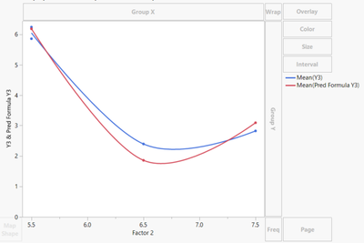

In the image below, would you know  how I could connect the red points with a line but leave the blue data as just points. Whenever I change to points or lines both sets are converted. I just want on set of points as a line (red) and the other set as just points (blue).

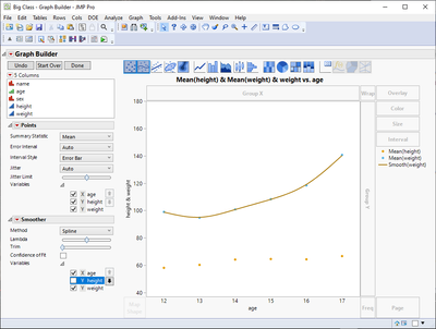

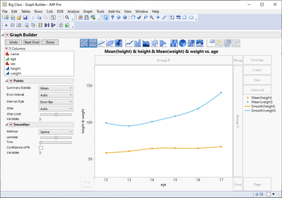

You seem to have to separate columns in Y-axis, like this
In cases like this you can modify Variables on the left side under different graphs, so remove other column from the smoother's variables
(do note that that the colors might get a bit weird as they are order based)
