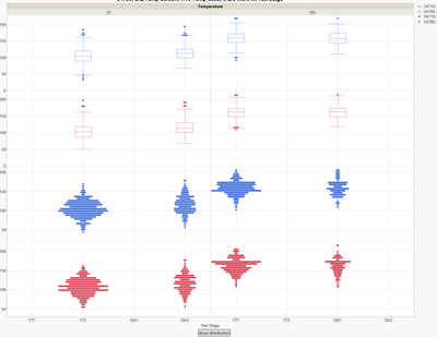

The code attached is not won't plot the Y - data columns as box plots after the 2nd one, and all the box plots wont share the same Y-axis. I want to make sure that the all the columns are plotted as box plots and share the same Y-axis. The code was working fine for plotting points, is plotting box plots different from plotting the points?

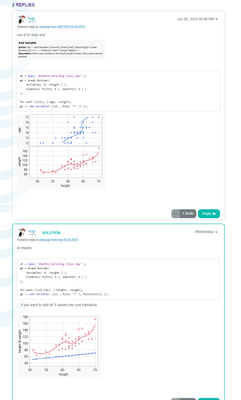

the difference between individual subplots and same subplot is explained here:
How to let user choose multiple columns for graph builder
The Trick:
"position(1)" - if you don't specify it to be 1, with every new Y variable position is incremented automatically and the column will be added with a new subplot.

hogi
Level XIII
Re: Some of the data columns won't appear as box plots in the graph
The Trick:
I see, thanks!
