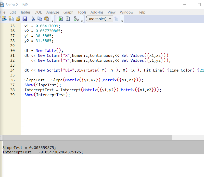

cwillden
Super User (Alumni)
Re: Slope and Intercept calculations in JSL
Hey @uday_guntupalli,
You still got the arguments reversed.  See the screenshot:slope_int.PNG
-- Cameron Willden
vince_faller
Super User (Alumni)
The order of your inputs are backwards.  On the function it goes slope(x, y) and when you call you're doing slope(y, x)

cwillden
Super User (Alumni)
You got the arguments backward for the Slope and Intercept function.  Just reverse the order of the matrices.
-- Cameron Willden

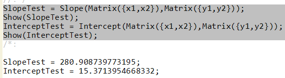

uday_guntupalli
Level VIII
@cwillden
       While that was a good catch, that did not change the results and the function doesn't match up to bivariateimage.png
Best
Uday
cwillden
Super User (Alumni)
-- Cameron Willden
