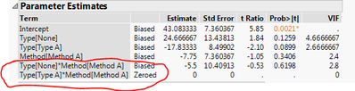

I have 2 categorical factors. The first is type of covering material, with 2 types available. Since it is also possible to use no covering material, this factor has 3 levels. The second factor is the method to apply these materials and has 2 levels (without overlap or with overlap). I am interested in fitting a model with the main effects and the interaction. When I try it to run this way (Table script "Test 1") the report indicates a singularity. So far no surprise, the model would require 6 parameters but the X matrix only allows 5. The problem is that the reports such as effect summary or interaction profiler don't work.

The singularity in this case indicates that you do not have all the right observations to estimate all the effects. You might try to design an experiment for these factors and desired model to see which runs are necessary. The minimum number of runs are sufficient for this purpose. Your data lacks some combinations of levels. You only observed Type = None with Method = Method A, so you cannot estimate the interaction effect.

Thank you so far. Since with Type = None I cannot distinguish between the methods I cannot estimate the interaction effect. Ie from the 6 parameters in the model only 5 are independent so that 5 are biased and one is zeroed. In my understanding it would make sense to have this Type[None] x Method interaction term zeroed.
Unfortunately by default the other one gets zeroed. Do you know how to tell the software which term to set to 0?

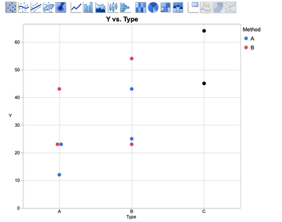

I am confused by "The problem is that the reports such as effect summary or interaction profiler don't work.".  What do you mean by don't work?
The issue with your data is that it is not balanced.  The instance where Type=None has no Method associated with it.
If you simply want to graph the data, Graph Builder is quite useful.
