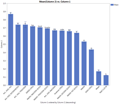

Hey!
Currently running the trial of JMP 15.1- so far it is awesome!!!
I ran into a problem tho- I did ANOVA and Tukeys on my data. Due to the funcionality of JMP I wanted to make a graph of the stats+my data where the Tukeys would be shown, however, when trying to implement the connecting letters to my bar graph I noticed that the Row Labels are overlapping with the error bars... Any way that I could move the bar labels higher, so that they are not in the way of my error bars?

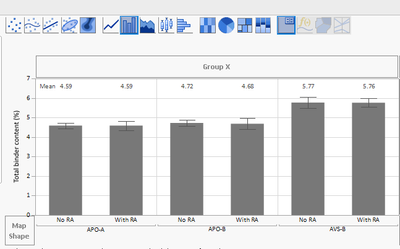

I've been struggling myself with this issue. Something that worked out for me was caption boxes
Instead of adding labels, you can go over your graph, do right-click, add, caption box. Then it will give you probably the general mean value on the right top corner (by default). You can then do again right-click, go caption box (there's an option after you've inserted it), and select the option per factor. That will show for every bar the mean value. In the same place, you can do all kinds of adjustments, eg place the caption box at the top, center, bottom, or even get other statistics like median. Just make sure there's enough space above your bars, by increasing the magnitude of your y-axis.
