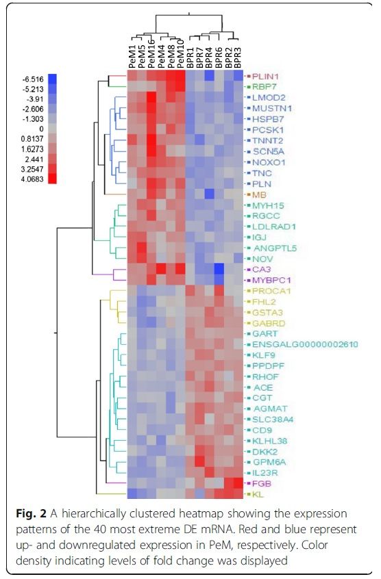

Thanks for the response. Sorry for the confusion, I was refering to the graphic from the journal you shared for fold changes.
You essentially have standarized data already. Standardize Data takes each Y (Column) and subtracts the column mean and divides by the column standard deviation (see below link).
http://www.jmp.com/support/help/13-2/Transformations_to_Y_Columns_Variables.shtml
Since you have normalized RNA-seq results in the same units, then definately uncheck standardize data since they all have the same scale (meaning) per sample for each gene (Y Column) . I am guessing that the normalized FPKM values are also log2 tranformed? You would then have over and under represented genes displayed as postive and negative, respectively, on the scale

shnias83
Level I
Re: Single legend for Hierarchical clustering heat map
Thanks Jim
I have attached a figure from a paper which has used JMP. I want to replicate that if possible.

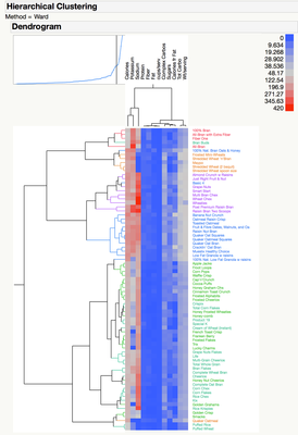

Jeff_Perkinson
What version of JMP are you using?
I'm having difficulty visualizing the multiple legends that you're getting.
Can you share a picture of what you're getting?
If not, can you reproduce the situation with one of the sample data sets (Help->Sample Data and search for "Cluster")?
Here's what I can get with the Cereal data.
-Jeff

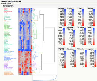

Jeff_Perkinson
Thanks, Jim. I'm going to blame that on Monday morning fog in my brain. ;) Yes, if I turn on Standardize Data in the Clustering launch dialog and get a Color Map and a Legend then I get this with the Cereal data.
@shnias83, notice that I have to have multiple legends because the colors mean different things for each column because the data has been standardized. You said that you want the standardization because it gives you the analysis and visualization you need. What legend would you use since the colors have different values for each column?
