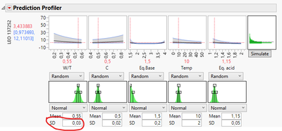

We are going in circles. The Profiler uses a fixed factor set point (e.g., W/T = 0.55 above ). It uses this value as the location of the chosen distribution, and it does not change during the simulation. It uses the spread (e.g., W/T SD = 0.03 above) to generate random deviates based on a selected distribution (e.g., normal distribution). If you have a RSD, say 5%, then the absolute SD is RSD * Location = 0.05 * 0.55 = 0.0275.

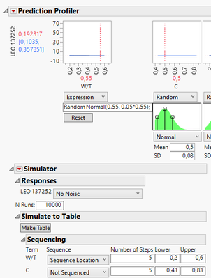

If I use a fixed set point of W/T = 0.55 and then apply the expression as shown:
Then SD is 0.55*0.05 = 0.0275.
Now, I want to simulate the defect rate applying the sequence location in the range from 0.2 to 0.6. When using the expression will JMP use a constant SD of 0.0275 for each the different locations or will the expression be interpreted as location*0.05?
Re: Simulations
I do not see a way to make the SD depend on the location with the JMP controls, even with an expression. There is no variable to access the current location or a way to specify a variable SD. You can sequence location or spread, but not both.
You can manually create a table of 25 combinations of W/T, C, and the associated SD, and then manually set the factor location and SD for each run. This approach could also be scripted as the Profiler and Simulator are fully scriptable.
