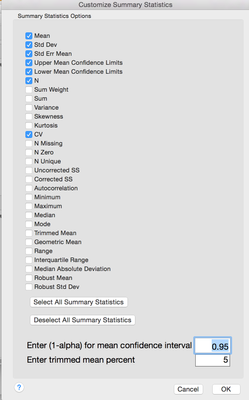

The Coefficient of Variation is what you need to display the RSD or %RSD.  To display the coefficient of variation look under the red triangle of Summary Statistics and select Customize Summary Statistics.
Check the box next to CV and then click OK.
