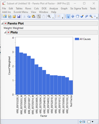

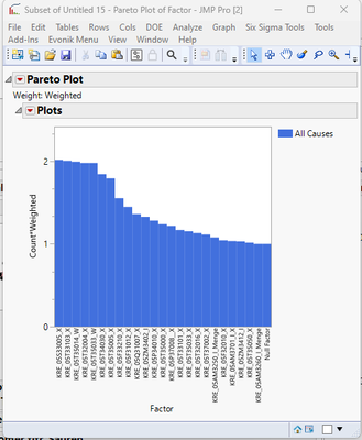

 Examples of the results are below on a Pareto Plot, where any factors that are introduced into the model fewer times than the Null Factor are simply removed. The first image shows the results of using the Simulate method, where the factor on the far right of the Pareto plot is the Null Factor. Similarly, the second image shows the results using the Bootstrap method, where again the Null Factor is at the far right.
  Why do I obtain two very different results for the two methods? Is one more "trustworthy" than the other? Why would I use one method over the other? Is one method more robust than the other? If you do get different results, why does JMP Pro have the two options?
