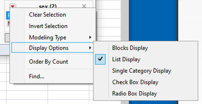

Where do you have your data filter? You can have local data filters in reports or global data filter like here in data table (see different Select, Show, Include options and Inverse)
You can also change the filter display to list for example and you can easily see that specific values have more values than other
