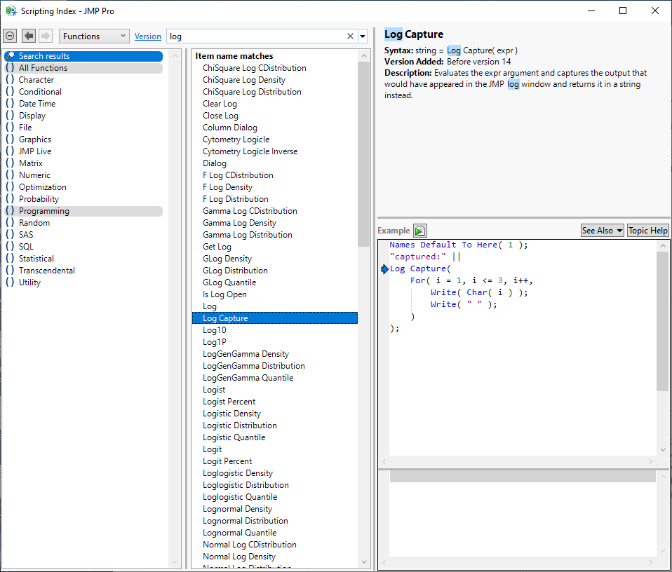

See if this function works for your purpose.
mat-ski
Level III
Re: Is there a way to capture logs without silencing exceptions?
Hi Mark, the function that you've linked is the one to which I was referring in my original post. The issue that I am having is that exceptions thrown in the expressions inside the capture are suppressed. For instance, in my snippet above, the Print in the catch block does not get executed.
I forgot to mention that you can save the result returned by this function for examination. @Craige_Hales' reply shows how you might use this function instead of printing from within any code provided as an argument. I'm sorry for the confusion.
