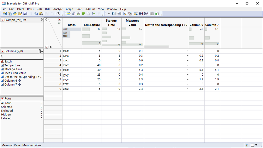

Jo_E
Level III
Re: Similar functionality as XLOOKUP() from Excel in JMP?
This file would be an example for such a table. And for each data set within the table the correct T=0 should be used for calculating the difference and the correct one is the one from the same batch and the same temperature, but also the storage time =0. I hope this makes it a bit clearer.
jthi
Based on your example data, the smallest Measured Value is always for Storage Time = 0, is this always true? If this is the case you can use Col Min
:Measured Value - Col Min(:Measured Value, :Batch, :Temperture)
And if this isn't always the case you need a bit more complicated formula
:Measured Value - Col Min(If(:Storage Time == 0, :Measured Value, .), :Batch, :Temperture)
-Jarmo
Jo_E
Level III
Thank you, that works!
