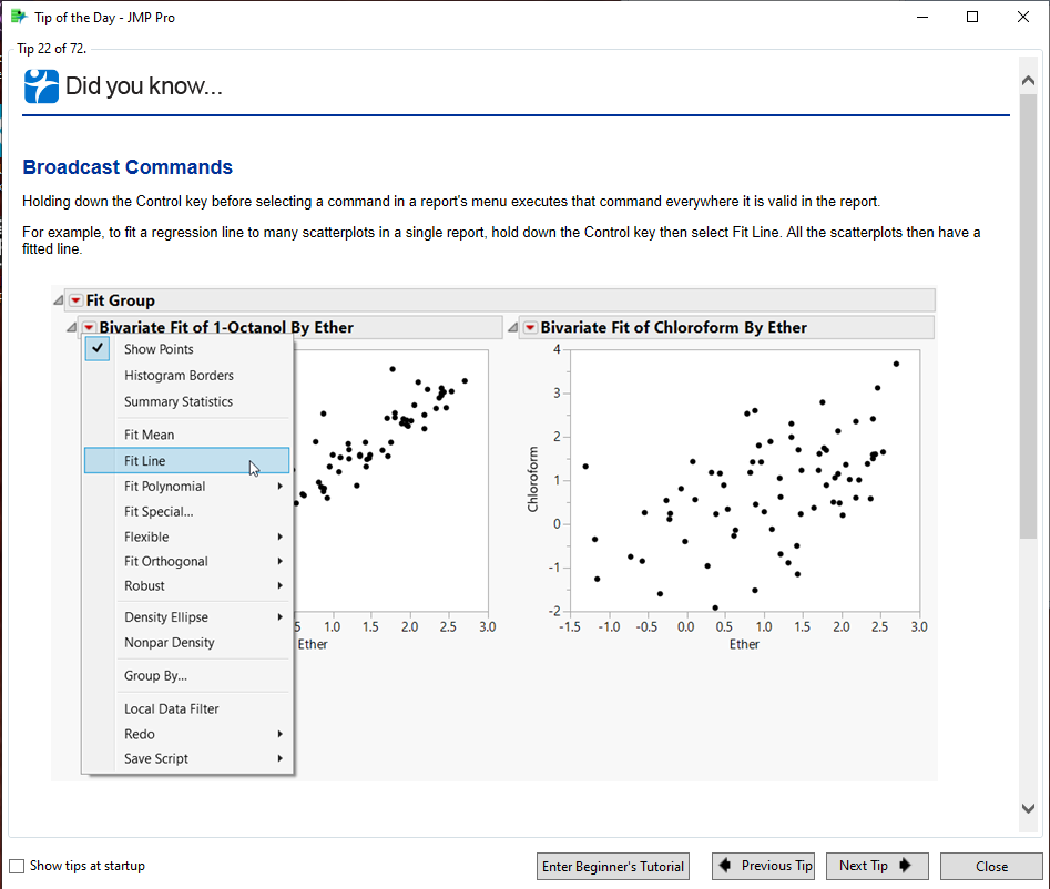

JMP has a universal feature that allows you to "Broadcast" the selections you are making to all of the objects in a report.  Just hold down the CNTL key as you make the selection and the choices you make will be repeated on all of your histograms, or goodness of fits etc.  Here is the Tip of the Day item on this capability
