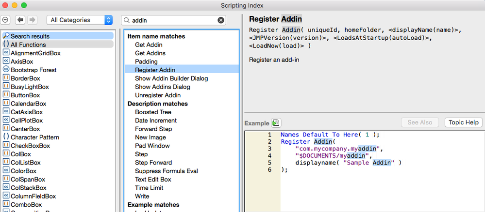

Hi, I have a question.
How can the person going to use the add in just add all the scripts at once rather than uploading each add in?
ian_jmp
Level X
Re: Share Add-In menu with other users
I went to 'Help > Scripting Index', and searched on 'addin':
It looks like (with a loop of some kind) 'Register AddIn()' would allow you to load add-ins programatically. So you could, for instance, have code in jmpStart.jsl that scans a location and manages add-ins (installs, updates, deletes) for each user.
