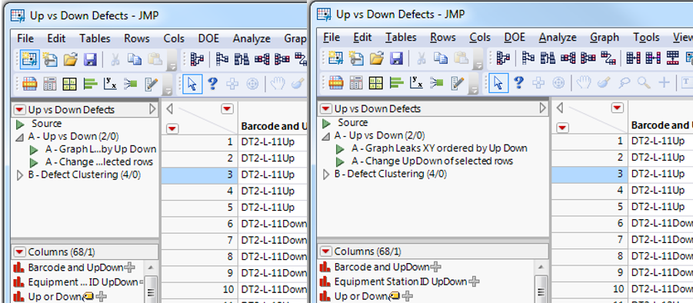

I have a script which generates a data table and adds new scripts so the user can do additional analysis and data modification.  The problem is that the script names are relatively long and get truncated by the size of the left panel when the new table is created.  I know I can set the size and position of the table with JSL, but is there a way to set the left panel size?  I thought that maybe H Splitter Box() would be the right answer, but I couldn't get it to work for me.
Basically, I get the image on the left, but I want the image on the right:

This was surprisingly possible, but it takes a couple steps.  See example:
Names Default To Here( 1 );
dt = Open( "$SAMPLE_DATA\Big Class.jmp" );
window = Get Window( dt );
sp = window << Find(SplitterBox(1));
sp << Set Width(300);

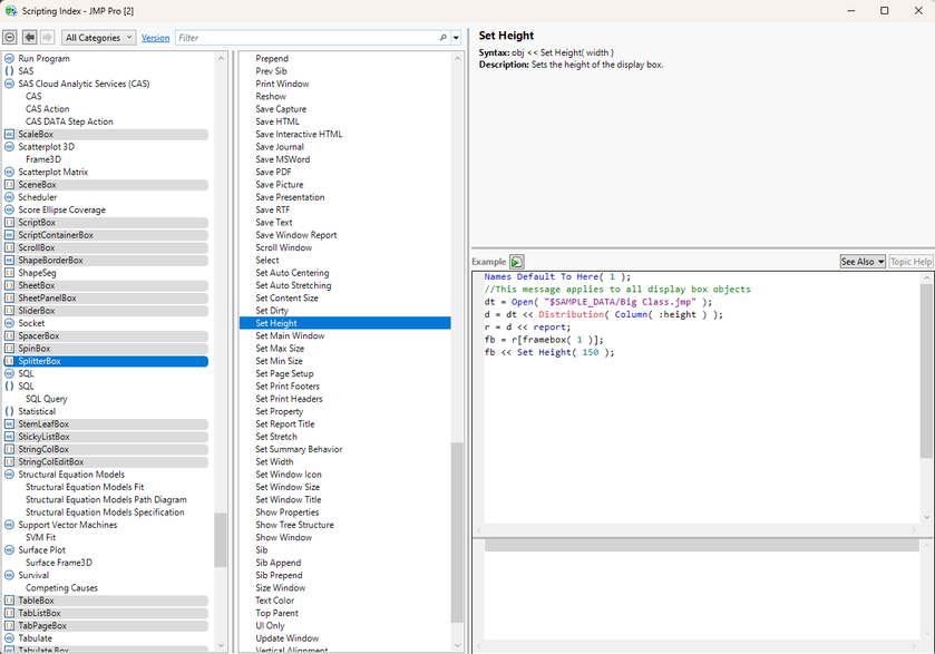

Hi, any chance you'd know how to adjust the height of the table script panel / SplitterBox(1) too? 'Set Size, Height, Size' all don't seem to work.
txnelson
Re: Setting data table left panel size in JSL?
The Scripting Index shows that
     Set Height
is a valid message for a Splitter Box
Jim

Ressel
Level VII
Yes, I saw that, but I couldn't get it to work. Leaning on @hogi's example:
// this works nicely
// set sizes specifies the size proportions of the three table panels. excellent
t = Get Window( dt );
sb = t[SplitterBox( 1 )];
sb << Set Sizes( {1, 1, 3} );
// trying to replace set sizes with set height does not work
sb << Set Height( 200 );
// similarly, leaning on the initial solution in this thread, this also doesn't work
sb2 = window << Find( SplitterBox( 1 ) );
sb2 << Set Height( 200 );
