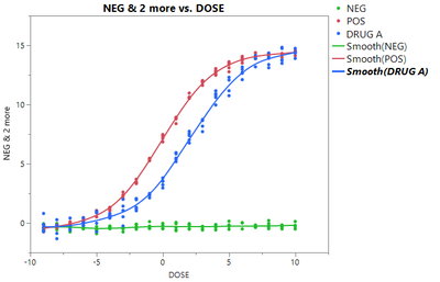

Could you confirm that you have curves (e.g. dose responses) for both your drugs and for your controls? Also, does your data look like the image below (for one drug only in this example)?
If it is the case, I would recommend using the Specialized Modeling > Fit Curves platform to compare the curves, including relative potency. If you still need to scale your Drug data, you can use the parameters from the the Fit Curves (Sigmoid > Logistic 4 P) output to retrieve the Minimum (Lower Asymptote of NEG), and the Maximum (Upper Asymptote of POS). I would also recommend that you read the following chapter: https://www.jmp.com/support/help/en/16.0/#page/jmp/fit-curve.shtml.
