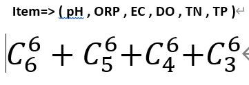

比如我有6個因子( :pH, :ORP, :EC, :DO, :TN, :TP ),我需要執行3~6個不同組合因子且不排序的主成分,全部結果會有42種。

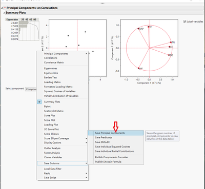

另外報告中滑鼠右鍵的''save principal components''有辦法使用腳本執行嗎?以下是我嘗試的腳本,顯然是不成功的。

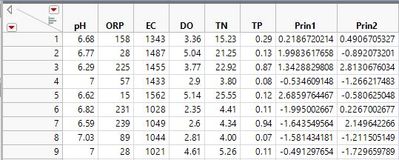

  你好,我需要的內容如附件(PCA)中箭頭位置,他需要使用滑鼠右鍵去選擇並決定要幾個成分後將結果貼在原本使用的數據表中,如附件(Prin)。

Here is an example using one of the JMP Sample Data tables.  It runs the PCA and Saves the Principal Component.  I am still confused about what you are trying to save to data table Output, but I showed how to save two guesses as to what you are attempting to save.
Please run the example below, and see what it does, and then give me some feedback.  Once I am able to get my understanding of what you are attempting to save to data table Output, modifying the script to allow you to run the 42 different combinations of parameters should not be hard to do.

For(i=1,i<=9,i++,dto:pca1[i] = dt:Prin1[i]);
For(i=1,i<=9,i++,dto:pca2[i] = dt:Prin2[i]);
For(i=1,i<=9,i++,dto:pca3[i] = dt:Prin3[i]);
For(i=1,i<=9,i++,dto:pca4[i] = dt:Prin4[i]);
For(i=1,i<=9,i++,dto:pca5[i] = dt:Prin5[i]);
For(i=1,i<=9,i++,dto:pca6[i] = dt:Prin6[i]);

另外想詢問,有辦法將組合寫成腳本嗎?想使用不同組合運行主成分,但不知如何下手。
