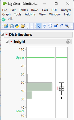

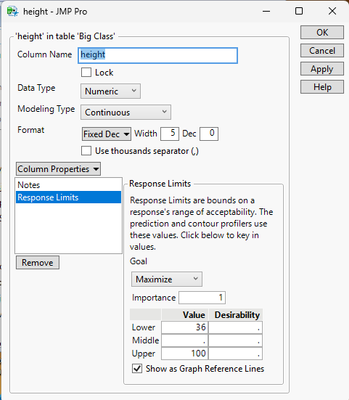

If you set the TI values as the Column Property, Upper and Lower Response Limits, and indicate to "Show Limits"
Those limits will be displayed on the graphs and will adjust the graphs to insure the limits are displayed
